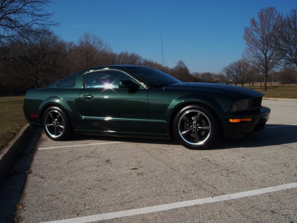

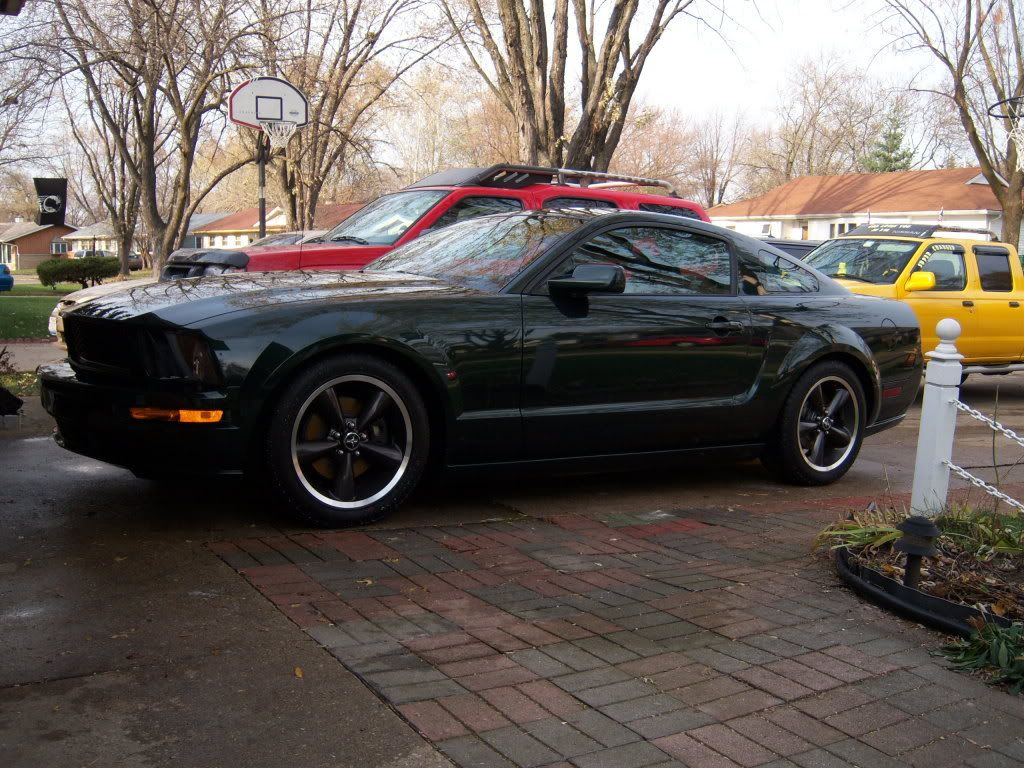

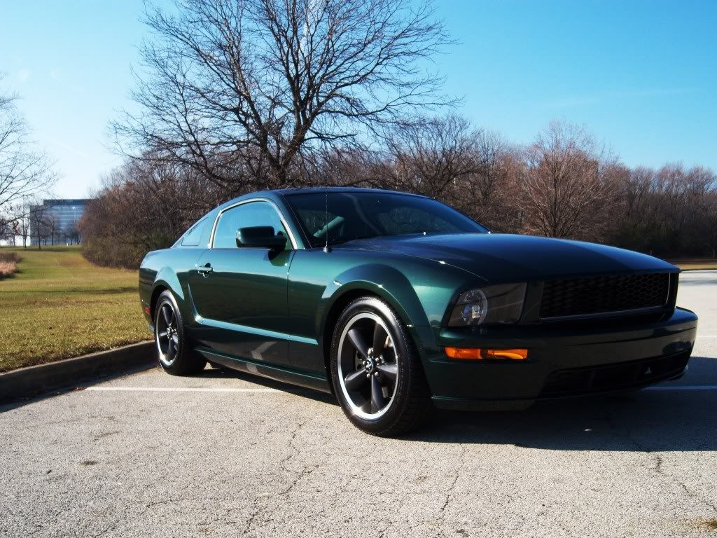

Nice Rico. Thanks for posting.
thought a different angle might help.
No problem on the photos ...just "paying it forward" for the info I have received from this site.
Sportlines do look great!
