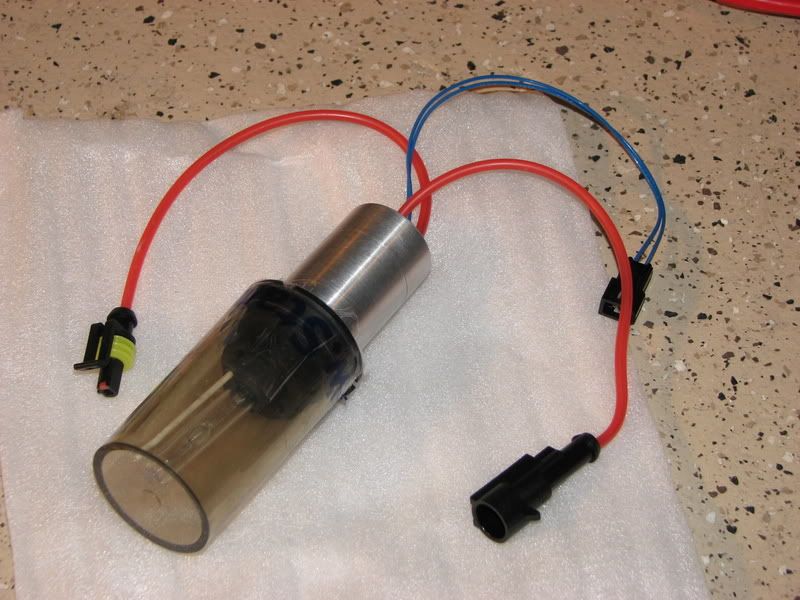

Got the 6000k Bi-Xenon HID kit from Stangmods.com in the group buy. All I can say is amazing, the pics dont do any justice and a few of them look more blue than they really are. I love them, just hope the five-o dont mess with me. The brights are great too. I really dont think they blind anyone outside the main area. My headlights are adjusted pretty low. Def worth the money

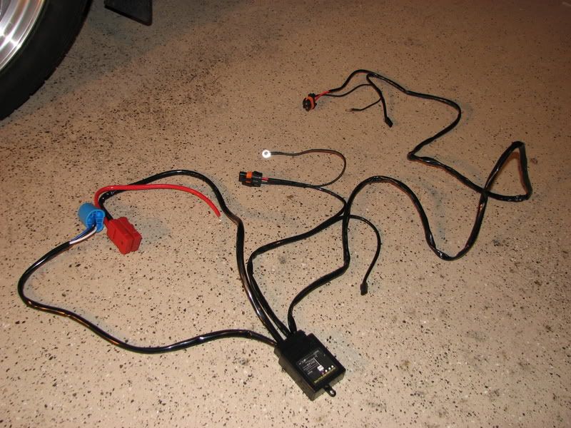

Wiring Harness
Relay?
Balasts
Bulb (in protective case)

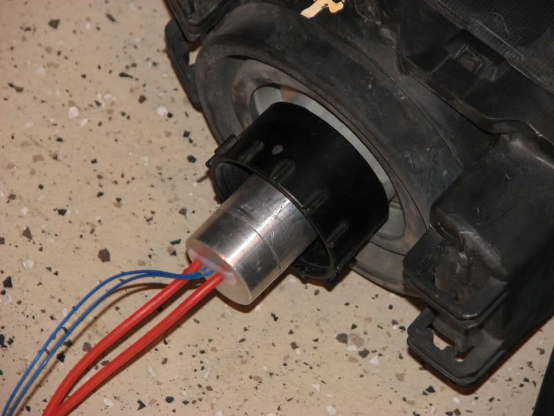

Bulb in headlight housing

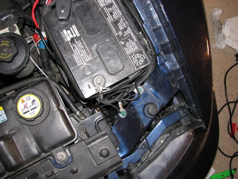

Passenger side balast location (I know its dirty)
Pic of what my engine looks like in the summertime
Drivers side balast location (between battery and headlight)

My main problem is that I did not get the same Bulbs that you did! Mine have no silver base! Mine have a larger Black base and the wires comes off of one edge (not the center). This bulb is different in that it has a small black reflector or something lthat looks like a reflector on on side of the bulb and a white stick thingy on the other side of the bulb. This bulb locks into place into a ring that you insert into the housing. The instructions say that if you do not get this correct, your low beams will not work.
Well, I cannot post a pic of the bulbs as I am out of town at the moment and do not have them with me. But my question is......how many of you that purchased the 6000K kit got a silver based bulb as shown in the install right up in this thread and how many of you got something else, (like Me)?
And, those of you that got something else (like me) how do you know that you have got it inserted correctly without having to put it all in the car to find out you do not have it right?

as far as the base I have no idea. That picture has the bulb protector on. I think you can see the reflector thing in that pic if you look closly.
1,855 Posts
No, that bulb in the picture does not have the reflector that I am talking about. I see now that it does have the white stick I spoke of but not the reflector on the opposite side of the bulb.
And the bulb I have has a large base shaped similar to a DC power adapter that you would plug into your cigarette lighter to charge your phone! The wires come off one edge of the base and are contained in a sleeve of that plastic flexible hose. Totally different bulbs that what are pictured here.
I am getting my Son who is at home with the bulbs to take a picture and I will post here in a minute.

maybe its just a different vendors bulb, mine were just placed in a plain box and wrapped in foam. Stnafmos could have easily bought parts from differnet vendors to make the kit up. give it a try and see what happens.
