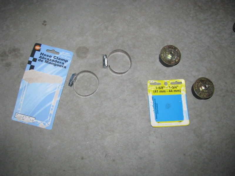

Finally got around to removing the intake silencer/resonator. It only cost me $8.47 plus tax, and took less than 10 minutes to complete. I got all the parts at Auto Zone, and are as follows;
(2) Expand Tite 1 5/8" to 1 3/4" Expansion Plug $2.99 ea
(1) Koehler 3/4" to 1 3/4" Hose Clamp, 2pk $2.49
Step 1:
Remove Intake tube from throttle body and filter head.
Step 2:
Remove factory hose clamps that secure the resonator to the intake tube. Discard after removing.
Step 3:
Place expansion plugs in holes, then tighten the nuts which expand the rubber. Then atttach the hose clamps and tighten.
Step 4:
Re-attach Intake tube to TB and intake filter and wha-la, done.
Final Notes:
Make sure you have all the parts before you start. The car will stall out if you attempt to start-up with resonator removed and the holes unplugged.
