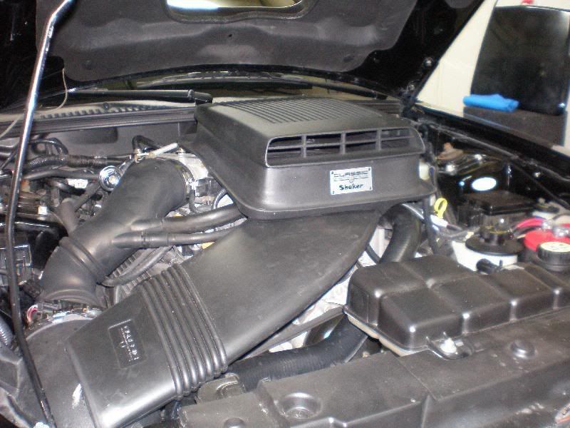

If your looking to see what a CDC looks like installed then here are a couple pic's of mine.
Can you use that se up with the standard bonnet vent?
if you mean the does the opening in the Mach 1 hood fit, yes it does.
