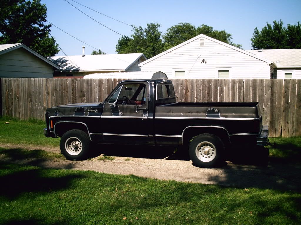

I"ve been working on my '79 Chevy pickup for the past couple of months. I sold my 71 C10 to buy this one from a friend's dad. I liked the truck because it was the opposite of my 71. It's a 4X4 shortbed that didn't need hardly any body work. My 71 was a two wheel drive longbed that needed plenty of body work. Shortly after I found out the transfer case doesn't work so the four wheel drive didn't work. My friend's dad only had it a short time before I bought it and he didn't know it didn't work. He's an honest man I've known my whole life and he wouldn't lie to me. Then the clearcoat started peeling like a bad sunburn. (see how this is getting better?) A few months go by and it starts to give me some mechanical issues. Passenger side brake caliper started locking up,burning oil like crazy, saggy suspension etc. I started saving and bought all new rotors, calipers, hub lockouts, a 4" lift kit, and a trans/transfercase combo. Had the the turbo 350 rebuilt with some stronger internals and a shift kit. Had a 2500 stall converter built to match the new motor. The motor is a 355 small block from my '71. It had a recent rebuild, so just swapped out the old heads for a set of Vortec heads. Had them gone through with a valve job, screw in studs, and Harland Sharp roller rockers. Had to get a new intake for the new heads, so went with the performer RPM Air-gap. I went with a comp cam to match the intake and stall converter. Should spin up to about 6500 rpm without any trouble.
Anyway, with alot of help from my brother, the new drive train is in and the lift kit is on. I ran out of money, so it's time to start saving up for a new rear driveshaft, tires, and guages. It at least starts and moves under it's own power now Probably next year for paint.
Here's some pics:
Before. People used to tell me it would be a perfect truck if it was a 4X4. Shouldn't hear that too much now.

The truck had recently been repainted. The trim on the rear quarters is all uneven, the doors don't line up right, and the clearcoat JUST started peeling shortly after I bought it. I took it to a friend that does body work and he said it was just a crappy paintjob. He quoted me $3500.00 to completely redo it. Pull the bed and all the glass, pull the trim and fill in the holes, and repaint. The plus is the body panels are all pretty straight and there's only some minor surface rust near the wheel wells. I'm just not decided on what I want to do with the paint yet. I'm thinking a flat black, or at least some sort of body protection like a rhino liner for the lower quarter panels since I'll be doing some four wheeling with it. I'm not too worried about the paint at the moment. I just want it to be drivable with the upcoming winter.

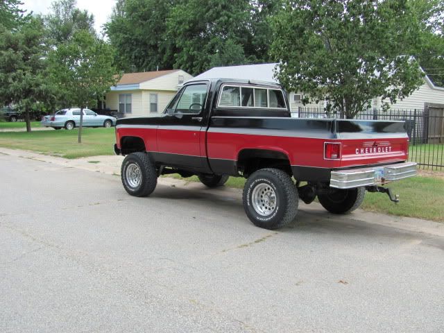

Back from the dead. Finally getting the truck painted. Will be stripping it down this Sunday and it'll be off to the painters next weekend. Got the driveshaft and tires done a while back. I'll get some more pics posted up once the paint is done. All I need now is gears, guages and a roll bar and it'll be set for a while until I get the big block built. Came a cross a free tall deck 427, but I'll need to upgrade axels and trans before I get that built.
Thanks man. It's finally getting close to where I want it. Probably be "done" next year. Next up is rear bumper, new wheels, and hopefully tires by winter. I really hate running these polished aluminum wheels in the snow/salt. Then next year will be gears and lockers and a roll bar. Then it'll be set to go wheeling. Been a long road, but worth it.
Forgot to update this thread. More progress. New 33x12.5 BFG Mud Terrain KM2's, got the lower part of the body covered in rhino liner, and finally the front bumper installed.

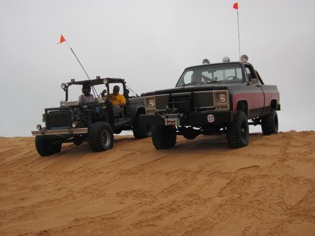

Aaaaaaaand done!!! It only took 7 years, but I believe the truck is done. (until something breaks) Gears, locker, roll bar installed. Decided to switch out the trans for a 700r4. Turns out not too many people have run a 700r4 trans with an np205 transfer case, so that was a bit more expensive and time consuming than I hoped. It all came together and I got to take it on it's first wheeling trip.
