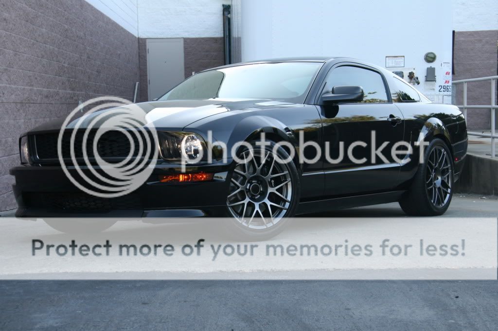

I lost the love to my beloved 3V a while ago and almost sold the car entirely but deep down knew I would regret selling the car… so I kept it. The car has been sitting for a little over a year now and I have finally settled on a vision for it.
If you are interested in reading my former build of the car, you can find it here:
http://www.imboc.com/forums/showthread.php?t=192767
Here are pictures of the car through its different looks/phases
December 2009 | When I took delivery of the car.
Summer 2010 – Summer 2011
Summer 2011-Summer 2012
Summer 2012 – Winter 2012
Present 2013
I’ve been through a lot with the car and it’s pretty obvious I have a solid emotional connection with it. I am pretty sure I’ll never get rid of it. Took me a while to come up with a build, and I’m still not done polishing the details, but the big picture is there.
