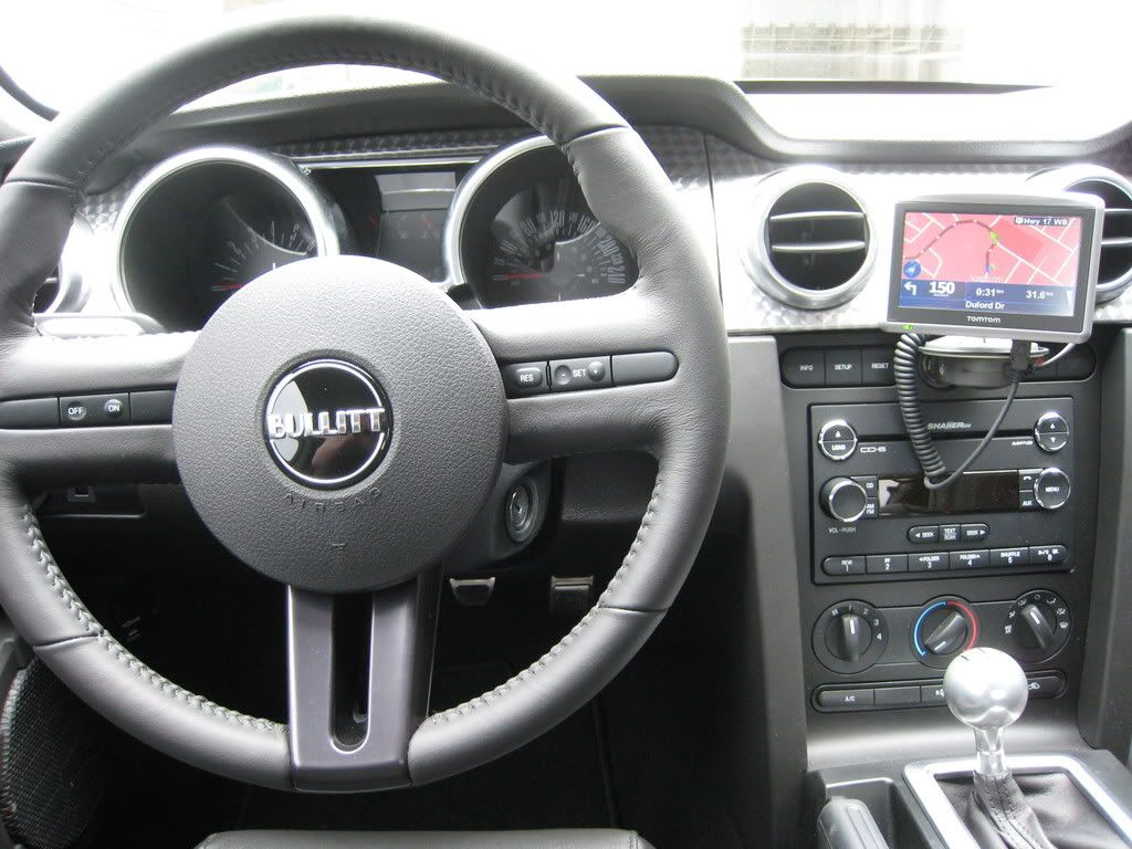

It always puzzled me that Ford put a 12V receptacle right in the middle of the dash in S197s. In most other cars they are in less conspicuous spots low on the dash. Well it turns out Ford had a better idea and so did the guy who came up with this great idea to mount a GPS in S197s. I saw this installation at a car show last week, and I modified it slightly to suit my Tomtom.
I got a cigarette lighter adapter with a mini USB connector at Radio Shack. I filed the soft rubber grip level with the plastic casing and simply glued to it the plastic disc which is supposed to be glued on the dash. I outlined the adaptor on the paper covering the pressure adhesive and removed that section.
You stick the bracket suction cup to the plastic disc and you have a complete assembly. You plug in the adapter in the 12V receptacle and it sits in the perfect location to view and change screens, and it recharges as you go. :smile:

I like it, but I'm not quite following what you did when you filed the grip. Can you explain a bit? :question:
Mike
This is a universal adapter and if you look at the picture which shows the underside, the black area in the center is made of soft rubber to grip the adapter when you insert and remove it, the grey part is hard plastic, I will call it casing for lack of a better word. The soft black rubber grip is convex so the adhesive on the flat disk would only grab a 1/4 in. or so in the middle. I filed the convex part flat and level to casing. Now the disc glues to an area roughly one sqare inch, which should stand up to repeated removals of the assembly from the receptacle.
Some adapters have flat plastic sides so you dont have to file the grip flat. The installation I copied from was more permanent: the guy glued the suction cup of bracket directly onto the 12V adapter. I looked to me like he J&B welded it.... aint never coming off.
Hope this helps Mike.
