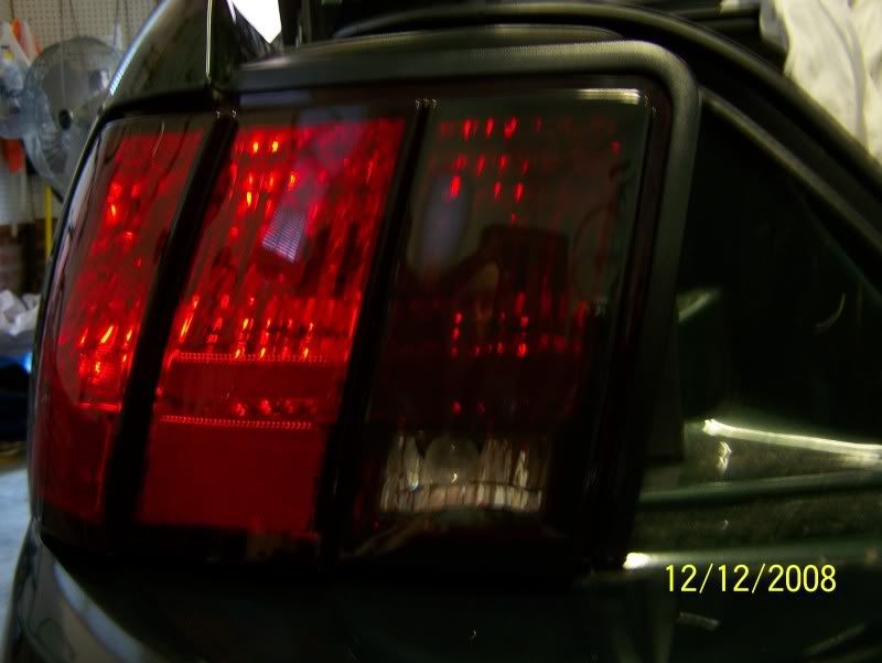

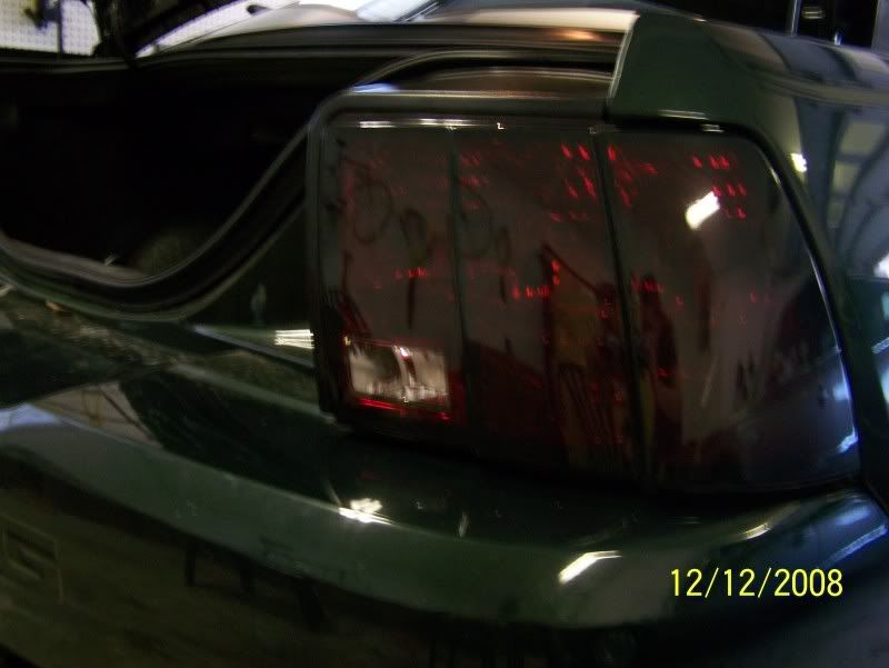

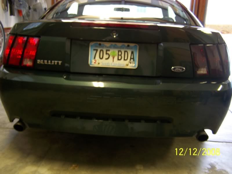

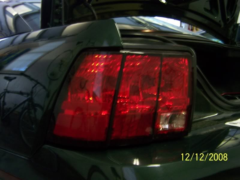

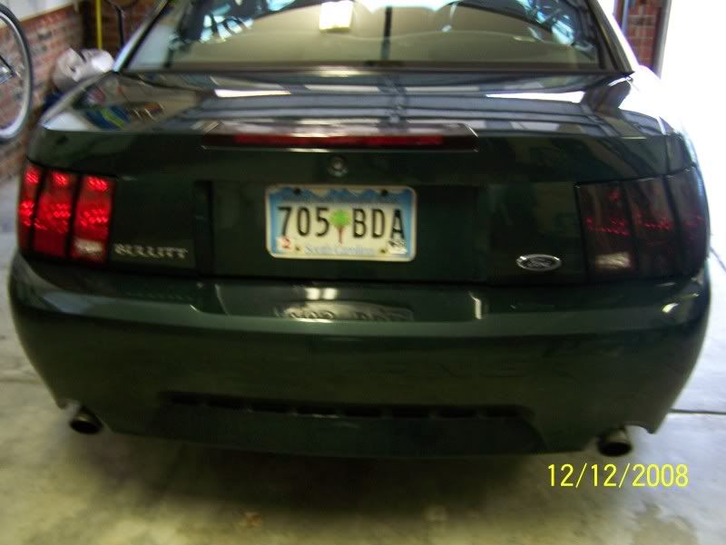

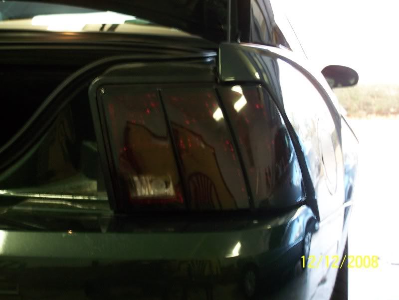

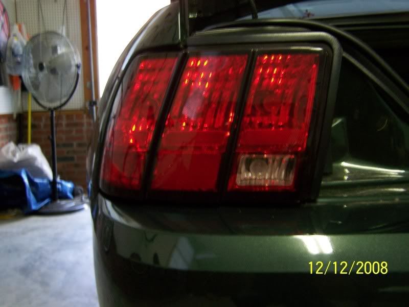

I have always liked the tinted tail light look on a mustang and ordered a set off of ebay from Xtreme Vinyls. They were $21.00 shipped. They are 20% tint pre-cut with the reverse light cut out (they are availabe without the cut-out, but I didn't want to sacrifice my reverse beam). I started to call around to see if a tint shop could install it easier than myself, but I got ranges from $40-120...So, here comes a do-it-yourself.
Me and my fiancee worked on it tonight and if you follow the directions, it really was not that bad. The key ingredient was heat from a blowdryer that softened the vinyl and allowed it to be stretched over corners and for creases/bubbles to be stretched and massaged out.
I think this is the perfect darkness because it allows plenty of light to escape when the lights are on while looking almost blacked out with them off. I also like the smoothness of the finish unlike the VHT spray tint that eventually looks chalky unless you keep it up with some coats of clear coat. But I can just take mine off I I get a fix-it ticket from the cops. Here are some pictures of the final product with comparison shots:

Yes, heat it up and pull it off. However, it will not go back on after you take it off. You would have to re-purchase more tint. I really can't see getting stopped for them because light shines through very bright when the brakes are applied.

Looks good! But be glad you don't live out here in CA cuz you would get ticketed for that for sure.
A friend of mine got nabbed for tinting his Cobra's tails and the fix-a-ticket fine would have been well over $300. So we ended up trading tail lights for a day and he went and got it signed off. lol
